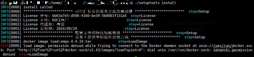

1. permission denied Prompted When Executing the Installation Command
Issue screenshot:
Solution:
Switch to the root user to execute the installation command.

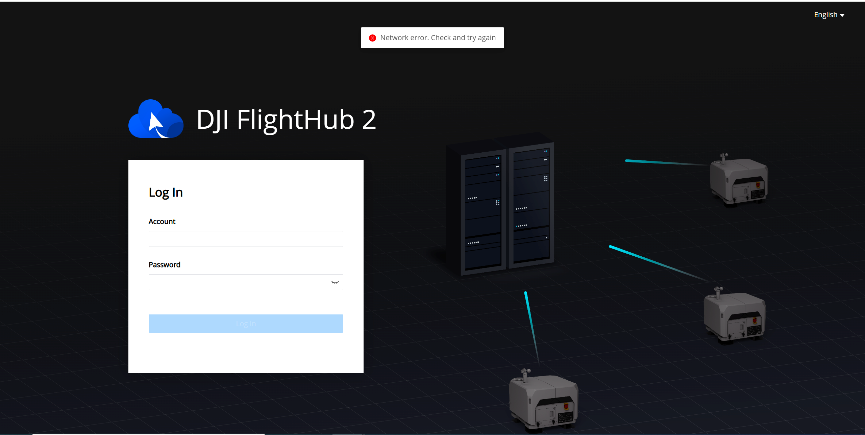

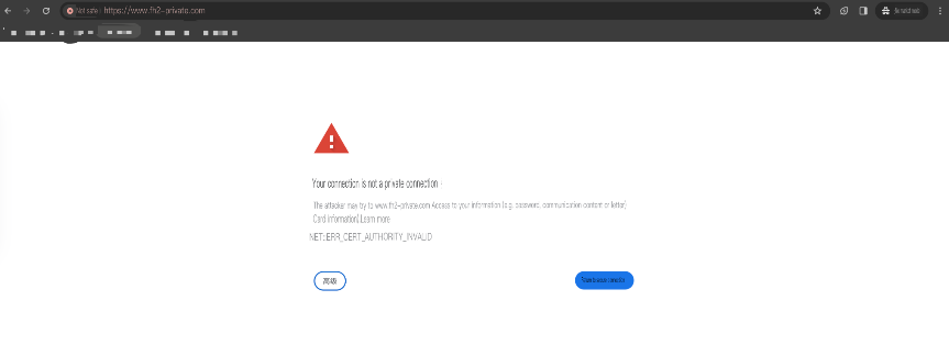

2. Unable to See the Log In Button When Accessing the System via Web
Issue Description:
Solution:
Refer to the document "Enable Self-Signed Certificate" in this manual to import the self-signed certificate and allow the browser to trust the certificate.
