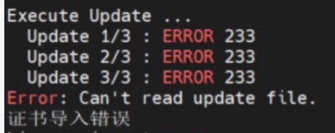

ERROR 233 Occurs When Installing the License
This error typically occurs when there is a mismatch between the "server fingerprint file" used during license creation and the "server fingerprint file" of the actual environment during license installation.
Troubleshooting Process
1. Check whether the certificates are confused
First, check the license used for deploying FlightHub 2 On-Premises to ensure that it is not confused with the license used for deploying the Terra reconstruction service.
2. Check the installation environment
If the installation environment has indeed changed:
  • For a trial license, you will need to reapply for a trial.
  • For an official license, contact your vendor (you will need to provide the latest "server fingerprint file" of the current environment to the vendor) to obtain an updated license.
