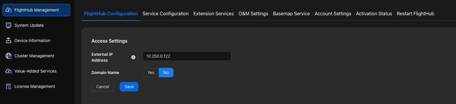

Changing the Domain Name / IP Address
You can change the domain name or external access IP in the Admin Console. The parameters are described below:
  • External IP Address (external access IP): The unified Cluster endpoint for web, API, and device access. After this address changes, devices must reconnect to the cloud.
    • Single Node: Enter the machine's LAN IP address.
    • Multiple Nodes: Enter the external VIP or unified endpoint IP address, and configure ingress forwarding and automatic failover yourself. For details, see “About the DJI FlightHub 2 Cluster”.
    • NAT / cloud server: Enter the public IP address (such as an elastic IP) and ensure that the required ports are reachable.
External IP and domain configuration
