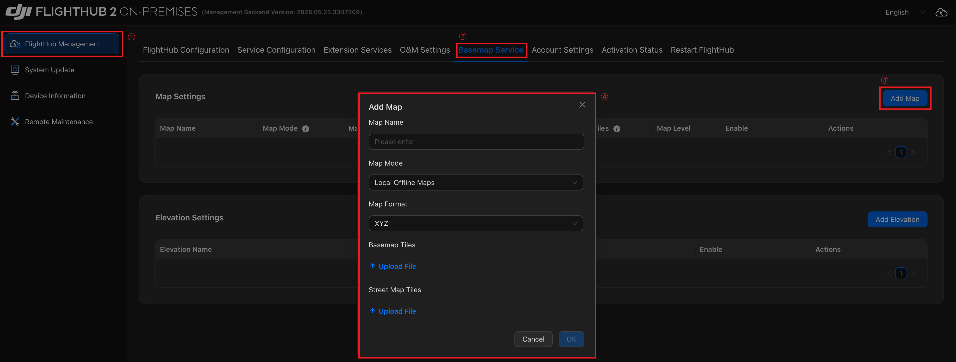

Data Publishing - Visualized Operation
Log in to the Admin Console and follow these steps to add a map:
- Go to 「FlightHub Management」→「Basemap Service」→「Add Map」.
- Set 「Map Mode」 to "Local Offline Maps".
- Set 「Map Format」 to "XYZ".
- Upload the tile files and click 「OK」.
Tip: For instructions on logging in to the Admin Console, see "Accessing the AIO Admin Console".
